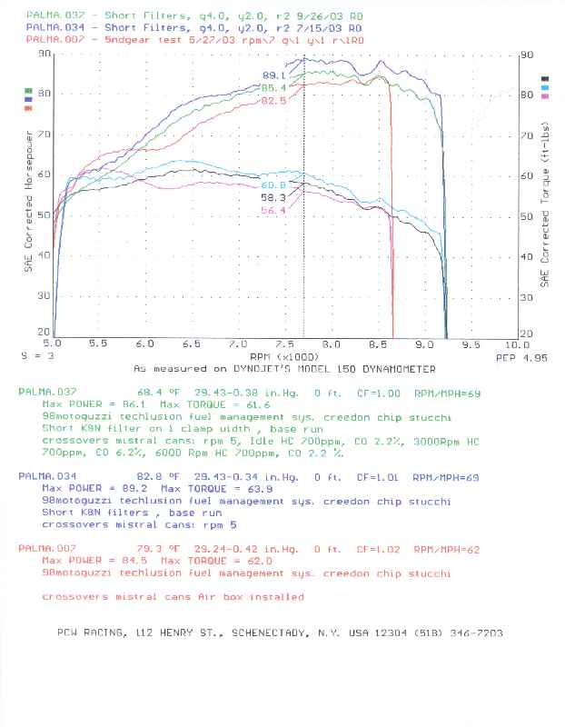

 afterAirFilter6.jpg (38186 bytes)Graph #6 has an Emissions Test for Carbon Monoxide and Hydrocarbons. You can see the red line and how restrictive the airbox is compared to the blue and purple lines .But if you take all the little things like Spark Plugs and Ignition Wiring, Wiring to battery #6 to #4 ,Temp Probe Brass Housing and so on it will all add up to a big increase in HP and Performance. If for some reason in your area the Environmental Requirements are more Stringent, you have plenty of room to lean with the Techlusion.I am not a die heart Techlusion person (but I must say it works for me) most of the people on C.O.G. use Power Commander if some one would send me some Graphs and they look good I will gladly get one and try it out and maybe write another article about it. I hope this update and the first articles has helped someone and if you Centauristi have any Graphs, Data or Info ( I am learning ever day) please forward them to me so I can keep the research up to date on the greatest bike in the history of  Motorcycling. TAKE CARE & BE SAFE../ JAMES R PALMA  maxok@nycap.rr.com
